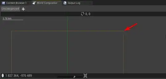

A question. In World Composition there is such a border of the world. As I understand it, everything that goes beyond its limits is destroyed, but is there an option to evade it?

1There are good reasons to keep your world content close to the origin when using floating point coordinates - going outside this range can result in unsightly artifacts or glitches. Games with immense worlds often swap you from one zone with one origin to a new zone with a different origin, so nothing is ever too far from that center point. – DMGregory Mar 26 '21 at 14:23
@DMGregory Thank you for the explanation. As I understand it is necessary to implement the transition to a new level when approaching this border. I'll think about how to do it normally. – FAR747 Mar 26 '21 at 14:29
