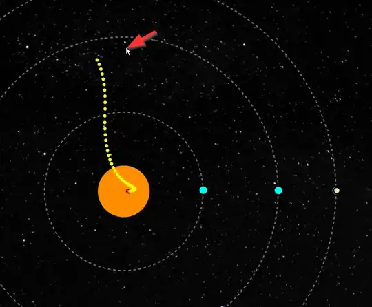

Going from a velocity of 0 is fine as shown here where my path properly shows my ship (center of the sun) moving to where I clicked just past Venus. enter image description here

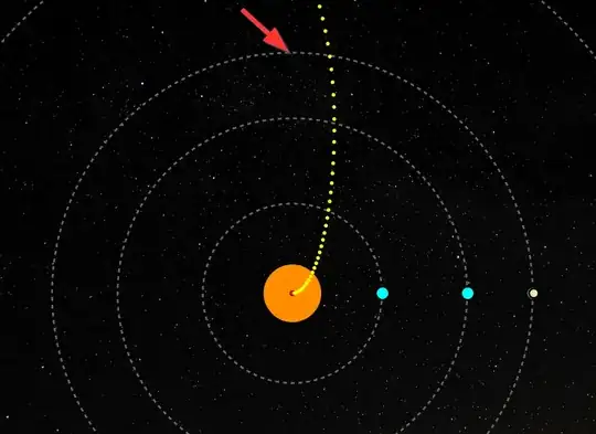

From here I jump a couple of hours and the ship has velocity from constant acceleration. I then give the ship a new destination and this is where I have thoroughly fried my brain the past couple of days.
The red arrow is the destination the ship is tracking, but my flawed math is sending the crew to their death. enter image description here

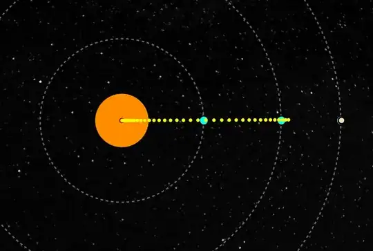

Red arrow points to the destination. The ship has a positive X velocity and the destination is directly above.
The new problem is that I don't know if I am using the correct vector to use for steering. The other issue is that I now have no idea how I am supposed to properly handle or calculate when/where/angle to decelerate so I can actually get to the destination. The crew are still guinea pigs on a no return mission.
