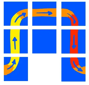

Problem tileset
Here's an example of a tileset that would cause trouble for this algorithm (assuming no tile rotation/flipping is allowed). The constraints of the corner tiles in the top and bottom row mean that yellow "north" roads and red "south" roads can only appear in alternation, and the number of blue gaps we expect to see between them is a function of the transition probabilities of the orange horizontal road. But when looking at a single strip at a time, WFC doesn't know that. It knows an empty blue tile can go next to a yellow road or a red road, and a yellow road or a red road can go next to a blue tile, so it might place blue-yellow-blue-yellow with no red in-between, or even if adjusted to avoid this (such as by distinguishing "left of road blue" from "right of road blue"), may still be prone to creating improbable spacings between the reds and yellows.
Even in less drastic scenarios than this, there might be multi-tile formations that span across rows and skew the observed probability of certain left-right pairs in a single row, compared to WFC's baseline probabilities.
