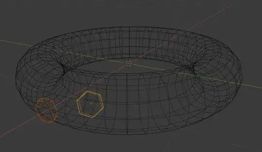

For illustrative purposes, here's a view of the torus and 2 hexagons that would lie on it (not real, this is just me mocking it up in Blender)
torus with hexagons on
What I'm struggling to understand is how to rotate the single mesh for a hexagon to its calculated normals at the position I want to place it.
i.e. How do I rotate some "unit" hexagon mesh (loaded from an OBJ file exported from Blender) to point in the direction of the 3 normals I've calculated they should be for each hexagon around the torus.

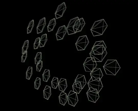

The output of the application given the above static 30 degree rotation is:
Can anyone help me unserstand how I apply the rotation to my items so they align to what I've calculated they should be?

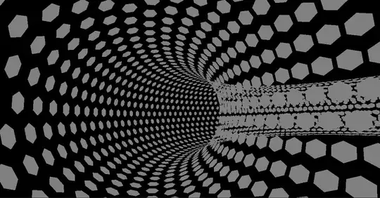

I converted to using a quarternion to hold the value of the rotation which I could readily create from the normals, so the "fix" was for me to understand how rotations work better.
For the libraries I was using, the fix was simply:
val q = Quaternionf().setFromNormalized(axes)
gameItem.setRotation(q)
Here's an image from inside the torus better showing what I was trying to achieve initially (i.e. the placement and rotation of the hexagons onto the torus). This is from my application.
torus of hexagons
