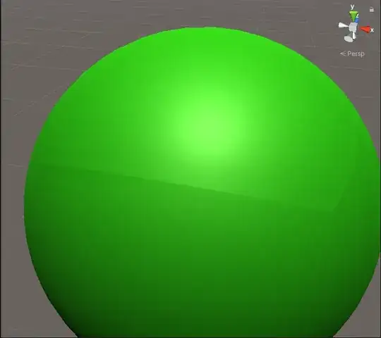

Here you can see seams without any fix: enter image description here
I tried to generate border for every side of the cube, call RecalculateNormals on the Mesh object and reassign vertices, indices and normals without the border. The result is better but not perfect (Solution A): enter image description here

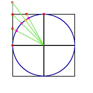

I was thinking about this border. If I generate one strip border and I normalize also the border vertices then these border triangles won't be there where adjacent mesh's edge triangles are located:
So I tried to move the border vertices to overlap the adjacent mesh's most outer triangles (most outer strip): enter image description here
And the result is almost perfect but the borders are visible (Solution B): enter image description here
Is it possible to remove seams fully? I want to use that solution where I just create border on the plane of the current mesh and not move to adjacent mesh. It's easier to create meshes with one unit wider.

The problem is that RecalculateNormals doesn't know about the adjacent meshes.
It works similar to the code I show in this answer: for each face in your mesh, it calculates a face normal. Then for each vertex, it averages-together the normals from each face it touches, proportionate to the area of those faces.
Let's take a vertex in the middle of your mesh. It's surrounded by faces...
  • to its right, with a normal leaning slightly to the right (+x)
  • to its left, with a normal leaning slightly to the left (-x)
  • in front of it, with a normal leaning slightly forward (+z)
  • behind it, with a normal leaning slightly backward (-z)
All these slight leans cancel out when we average the normals, and you're left with a normal that points straight out along the line joining the vertex to the sphere's center.
Now let's take a vertex on the edge of your mesh. It's missing faces on one side to counter-balance the leaning of the normals from faces on the other side. So it gets a normal appropriate to those faces that are present in the mesh, without considering the absent faces beyond the edge. The result is a slight bias inward toward the center of your mesh.
The simplest solution here is to just calculate your own normals. If your mesh is a sphere, you can take the vector from the sphere's center to your vertex and normalize that. Now it's exactly the vertex normal you want, no matter whether it's on the edge of your mesh or somewhere in the middle. And the calculation is consistent, so the next mesh chunk you generate will exactly agree with this normal at the place where they meet. This may even be more efficient than RecalculateNormals since you're saving it the work of computing and summing the face normals.
