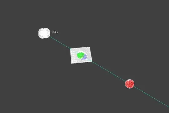

I tried, foreach obj:
// basePos is glm::dvec3
// renderScale is a float
const glm::dvec3 shifted = glm::translate(-worldOrigin) * glm::dvec4(basePos, 1.0); const glm::dvec3 scaled = glm::scale(glm::dvec3(renderScale)) * glm::dvec4(shifted, 1.0);
// draw using 'scaled' as position for obj
Here is the result, where green sphere is (0,0,0), red sphere is this 'worldOrigin' / shiftPos, i.e. (1000, 1000, 0) in the above example, and the white spheres are the objects that 'should' be scaling around green. (Ignore the blue sphere and the text - was a leftover). Shown is what happened when I pushed the scale down such that the translation of each white sphere was very small - they converged on -worldOrigin (inverse of red), and when I started increasing the scale, they moved towards and past the red. I am unsure of how to get them to scale centered around green (expand/retract out/in to it).
Thanks!
HateDread
