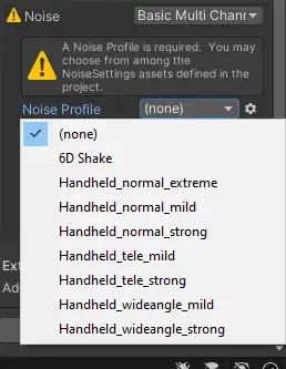

You can try the Cinemachine (which can be found in the Package manager). Use its noise Component
Hope it helps. Let me know.
  • I am working within a custom environment so I don’t have the benefit of those settings – J.Doe Sep 09 '20 at 16:49
