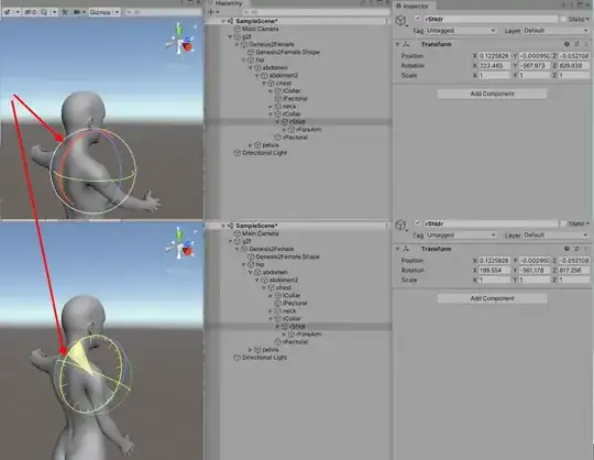

I wanted to move my character's arms up and down in a straight way.
The Rotation Gizmo tool can do exactely that.
Playing with the wheel of the Rotation Gizmo tool in the attached screenshot (marked with red arrows in my screenshot), I could move the arms down in a straight way:
I can do the same using the following script:

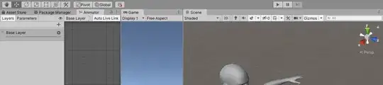

  • Do you want the gizmo to operate like it's in "local" mode, or "global" mode? (You've cropped this part out of your screenshot) – DMGregory Sep 06 '20 at 23:41
  • @DMGregory I have added a top menu screenshot to my post. I think it's the Global mode, but not 100% sure about it. – tmighty Sep 07 '20 at 06:45
