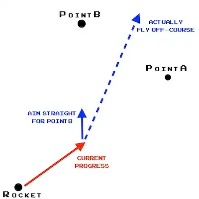

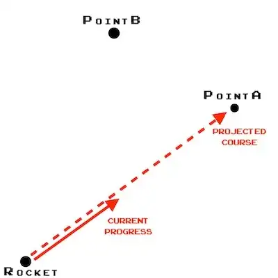

Imagine a rocket is accelerating in a straight line toward PointA, picking up momentum every frame, then suddenly decides it wants to go toward PointB instead.
It can't just turn straight toward PointB and start accelerating, because the new acceleration plus the pre-existing momentum will carry it wildly off-course, and not straight toward PointB.

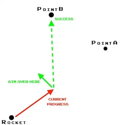

It would be more efficient to turn and start accelerating in some specific direction that will bleed off the unnecessary momentum but keep any useful momentum, course-correcting so that it is now moving toward PointB.
I'm trying to figure out how to calculate that "specific direction" that the rocket needs to start accelerating toward, in order to efficiently reach PointB. I have the rocket's position, the Vector3 of its inertia, and the Vector3 locations of PointA and PointB, but I'm not experienced enough in Vector Math to totally understand what's needed.
