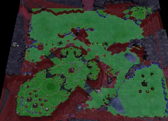

I saw a GDC video, where the Starcraft 2 devs talked about using constrained Delaunay triangulation, and you can kind of see it when you look at the pathing mesh in the Starcraft 2 editor (see below). However, very few of the generated triangles are legal, due to the number of constraints in the map layout. Still, I am assuming the Delaunay algorithm influenced the selection of points to triangulate, in order to get the best triangle coverage.
However, I can't find any further info on how this might work. How does one start with constraints, points connected by fixed lines, and then "fill in" the remaining lines to generate triangles that are a best-effort attempt to not be overly stretched or narrow?
Edit: Screenshot example from Starcraft 2 editor: Screenshot from SC2 editor, showing pathing mesh

  • I've edited the post to include a link to a screenshot from the Starcraft 2 editor, showing it's pathing mesh. It appears to do a very good job of selecting triangles that cover as much space as possible. But you can also tell that, being constrained, the result isn't true Delaunay, just pushed in that direction. I don't know how they did that. – Nairou Jun 21 '20 at 18:56

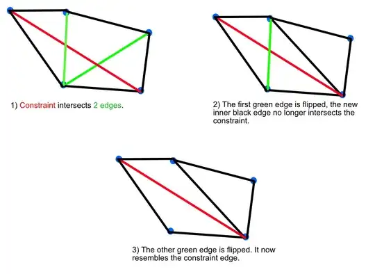

You're almost there. Once you have a delaunay triangulation of all the points (including constraint points) then:
foreach constraint edge:
  1. Find all existing intersecting edges in the triangulation
  2. 'Remove' these intersecting edges (see below)
  3. Restore the delaunay triangulation
Regarding step 2), here is a description from Eric Nordeus that summarises this step:
"The idea here is that all possible triangulations for a set of points can be found by systematically swapping the diagonal in each convex quadrilateral formed by a pair of triangles. So we will test all possible arrangements and will always find a triangulation which includes the constrained edge."
The quadrilateral is formed from the 2 triangles that share the edge intersecting the constraint.
Get the 3 vertices for the triangle the intersecting edge is on and then get the 'opposite' edge of this edge (in the half edge data structure on the Habrador blog, the opposite edge has the same vertices, but they are swapped in order).
If these 4 points form a convex quad then you can flip the edge.
If the new flipped edge intersects the current constraint you push it back on the intersectingEdges list, otherwise you have a new edge that no longer intersects the constraint.
Here's a very simple diagram that hopefully helps illustrate the basic concept: removing intersecting edges
