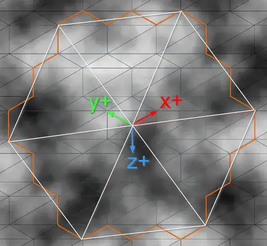

Here's a working example. For starters, I built a mesh with "pointy-top" hexagons, using axial coordinates where the x-axis points up-right and the y-axis points up-left (and the third implicit axis z = -x - y points down).
Coordinate Conventions
The white twisted hexagon is the isometric triangle lattice we'll use to evaluate our noise, at the coarsest tiling frequency.

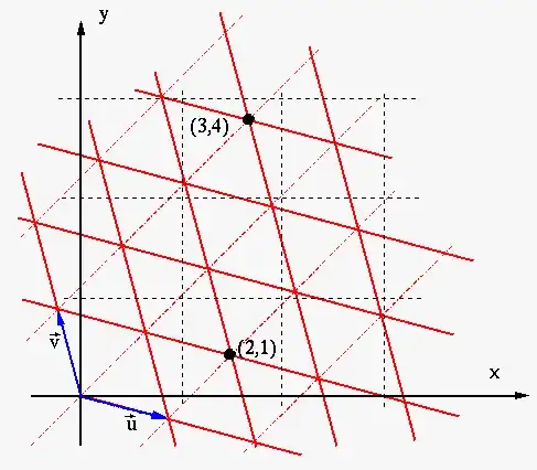

To make finding the 3 closest lattice points easy, we'll apply a coordinate transformation. An isometric grid is really just a square grid, split along its diagonals, and squashed slightly to make the diagonal the same length as the other sides.
Mapping between square and isometric grids
(Diagram from Understanding skew factors in Simplex/Improved Perlin Noise by Kristian Nielsen)
With this trick, all our lattice points sit on integer coordinates. And we can get any finer subdivision of this grid by just multiplying our coordinates by an integer.

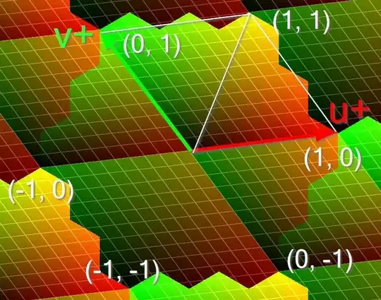

So to proceed, we need to transform our xy axial coordinates into these uv-space coordinates. (Here shown with a colour gradient: more red = more U, more green = more V)
UV Space
To do this, lets get the positions of the ends of those U & V vectors in axial coordinates. For the coordinate system I used, that's :
uBasis = new Vector2(radius + 2f / 3f, -radius - 1f / 3f);
vBasis = new Vector2(        -1f / 3f,  radius + 2f / 3f);
We can think of these as the columns of a transformation matrix that maps (1, 0) to uBasis and (0, 1) to vBasis. To reverse that transformation, we just invert the matrix:
float determinant = uBasis.x * vBasis.y - uBasis.y * vBasis.x;
toU = new Vector2( vBasis.y, -vBasis.x) / determinant;
toV = new Vector2(-uBasis.y,  uBasis.x) / determinant;
Then we can convert the axial position of any point into UV space by writing:
u = Vector2.Dot(axialPosition, toU);
v = Vector2.Dot(axialPosition, toV);
I did this for each vertex in my hexagon mesh, and saved the results into a UV texture coordinate channel, so I could do the rest of the work in a shader. The logic is basically the same if you do this CPU-side though.

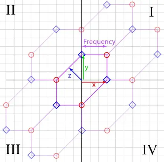

Okay, finally we get to where the magic happens: the wrapping of our corners to ensure that opposite sides of our hexagon are choosing the same pseudo-random gradient, for seamless tiling.
Inside this method, we're going to be working with integer points on a stretched hexagon that looks like this:
Wrapping domain
Note that at the six outer corners, we're really only allowed to use two distinct values. As soon as we pick a value for one corner, we have to pick the same value for two other corners, in order to match our adjacent repeats.
Apart from these special corners, our goal will be to determine whether we're on the remappped edge of, or inside of, one of the six neighbouring hexes. If we are, we want to shift that hex back to the origin, to bring our sampling point to a canonical point inside/on a non-remapped edge of our central hex.
There are probably much more elegant ways to do this wrapping, but here's my stubborn kluge:
float2 wrap_corner(float2 corner, int frequency) {
    // Reintroduce a third axis z, pointing perpendicular to our diagonal side.
    float3 hex = float3(corner.xy, corner.y - corner.x);
    // We'll exploit some symmetry using absolute value & sign information.
    float3 hexSign = sign(hex);
    float3 absolute = hexSign * hex;
// Remap the outer corners at (±frequency, 0) and (0, ±frequency)
// to the corners at the ends of the diagonal.
if (max(absolute.x, absolute.y) == frequency
&& (absolute.x + absolute.y == frequency))
    return (hexSign.x + hexSign.y) * float2(-frequency, -frequency);
// We want to remap corners from one side to the other side,
// not exchange both sides! So shifting our threshold excludes one side.
absolute -= hexSign * 0.1f;
// Points safely away from our remapped border, or the two diagonal corners,
// can stay exactly where they are.
if (max(absolute.x, max(absolute.y, absolute.z)) < frequency
    || hex.z == 0.0f)
    return corner;
// If we're in either of the two neighbouring hexes in quadrant I or III...
if (corner.x * corner.y > 0) {
    // Shift depending on whether we're in the top or bottom neighbour hex.
    float shift = step(absolute.x, absolute.y);
    corner += hexSign.x * frequency * float2(-2 + shift, -1 - shift);
} else { // Otherwise, we're in quadrant II or IV
    corner += hexSign.z * frequency * float2(1, -1);
return corner;

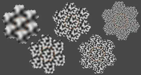

With this in hand, you can make hexagon-tiling noise of any integer frequency (here I show 1, 2, 3, 4, and 8):
Noises of various frequencies
Or you can sum multiple octaves at different frequencies and amplitudes to get a cloudy FBM/turbulence look like in the first image. Or apply any of the other standard techniques you might use with Perlin noise, like Ridge noise, etc.
