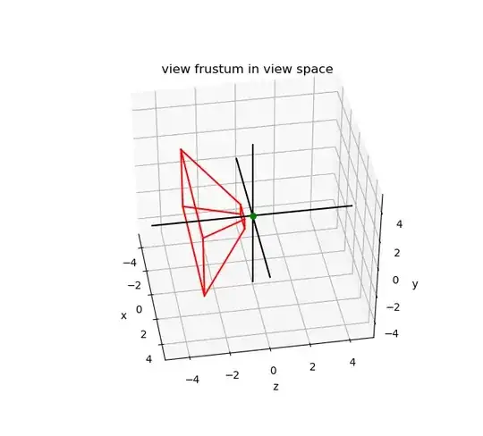

Here is a plot of the frustum after the transformation to view space:

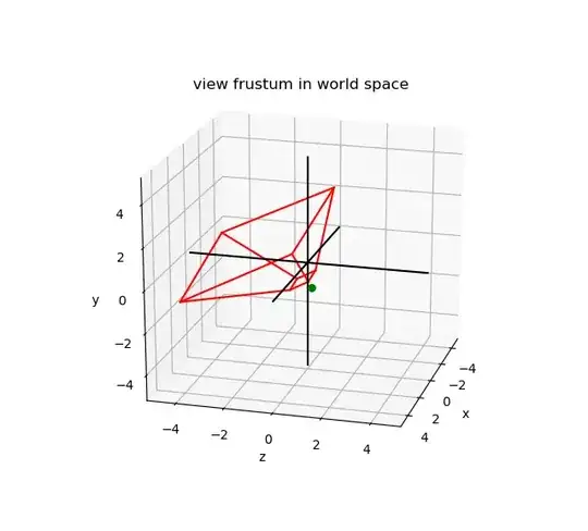

The green dot is the actual camera position. Here is the final result in world space: enter image description here
I hope that helps you to understand the approach. If not, copy the script and run it. There are also some alternative calculations included, that you can use (In case you get an error, you missed probably to include some other comment). If there remain any questions, don't hesitate to ask, but consider creating a new question referring to this one for more complex questions to avoid extensive chatting in the comments.

render_frustum(points=points_view, camera_pos=[0, 0, 0], ax=ax_view)
ax_view.set_title("view frustum in view space")

plt.show()

  • Thank you! The visual aids were perfect btw, helped me see what was actually happening! – Sammi3 Jun 07 '20 at 20:08
