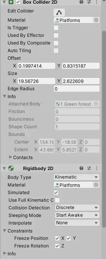

Bellow I have the images showing the inspector of both the character and platforms/wall respectively.
Player Inspector[![Wall Inspector]4
Also: I'm moving the character using transform.position += Vector3.right * speed * Time.deltaTime;

  • I'm not able to view your videos at your provided links. Please also show us how you're moving these objects. A common mistake is to move the objects with the Transform component, bypassing the physics engine that's responsible for resolving collisions. – DMGregory May 20 '20 at 15:17
  • I have replaced them with working links – ManoTech May 20 '20 at 15:32
  • Don't forget to include the information requested about how you're moving your objects! Be sure to also show us how you've set up their colliders, rigidbodies, etc. in the Inspector. A good guideline is that your question should contain all the information we need to reproduce your problem if we start from a new, empty project and can't ask you any follow-up questions. That means there's absolutely no obstacles to verifying the source of the problem and testing solutions, helping you get proven answers quickly. – DMGregory May 20 '20 at 15:41
  • Thanks for the heads up! – ManoTech May 20 '20 at 16:13
  • Yep, there's your problem: transform.position += ... says "forget physics, just go to this exact position, no matter what colliders might be in the way". If you want to respect physics influences like collisions, you need to use the Rigidbody2D to process your movement, not the Transform. – DMGregory May 20 '20 at 16:26
  • How would you suggest? Add some horizontal force? – ManoTech May 20 '20 at 16:27
  • Please see the answer on the linked duplicate. Setting a velocity, applying a force, or using MovePosition are all valid solutions. If you run into any trouble solving your problem with a rigidbody, feel free to edit this question to show what you've tried, and we can re-open it for answers specific to that particular problem. – DMGregory May 20 '20 at 16:34
