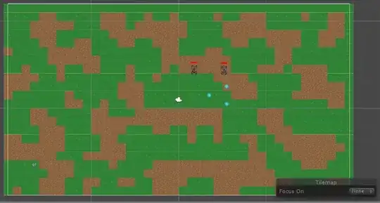

The map generated by the code below: (frequency of 0.3) enter image description here
The problems with this method:
  1. No randomness. I know Perlin Noise is NOT a random function, so how can I add random factors to generate a different map each time?
  2. How can I control the number of islands (e.g.: with a factor that can determine "more islands" or "less islands", not an approx. number)?
  3. How can I control the size of each island (again, with a factor. I don't care about exact size)?

    Are you dead-set on using Voroni diagrams for this? Because I would do this with Perlin Noise and control the ratio of grass to soil by picking the cutoff value between one and the other. But I don't want to claim that this isn't possible to do with Voroni diagrams. I don't have enough experience with them to judge that. – Philipp Mar 27 '20 at 11:22
  • Well I've tried with Perlin Noise but there were 2 problems: 1. The generated maps were not of islands but more of single tiles as I said. 2. I didn't manage to add random element to the map generation. So I've switched to Voronoi. So far it's better, but not perfect yet. – lihail Mar 27 '20 at 11:29
  • It sounds like you were using a mix of frequencies of noise too high for your needs. Bringing this down to fewer, bigger, blobbier islands should be just a matter of tuning your noise parameters. Adding an offset or re-shuffling your permutation table can add randomization. I'd second Philipp that noise looks like what you want, and you should consider editing your question to show your problems with using noise so we can help you solve them. – DMGregory Mar 27 '20 at 11:37

  • @DMGregory could please you explain what you meant in the 3rd comment? The only noise parameter I have is the frequency. Josh what do you mean by scale? – lihail Mar 30 '20 at 11:08
  • Don't forget to search for existing Q&A that covers your topic. Josh is also talking about the frequency. – DMGregory Mar 30 '20 at 11:10
  • @DMGregory that helped A LOT, thanks! Eventually I didn't manage to answer the questions I asked, but what I've managed to achieve is good enough. – lihail Mar 31 '20 at 14:51
