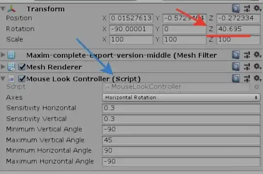

My script(MouseLookController) is attached to a GameObject and I want to limit it's rotation between 90deg and -90deg.(Rotation is 40 deg in example image)
Problem is I can't access this value to check it. How can I access the rotation Z of this gameobject?
I've tried:
transform.localEulerAngles.z
transform.rotation.z
transform.eulerAngles.z
Meaning they won't return 40.695 value, where is this value currently stored?
Couldn't find it in the GameObject.

  • It's very unusual to manipulate a z (roll) angle in a mouse look controller. Generally we want to work with x (pitch) to look up & down, and y (yaw) to look left & right. Z twists/rolls the view. I notice your pitch is a full -90 degrees here, so its local forward vector (z+, the blue axis in Unity) is looking straight up to the sky. Is it possible your object is was imported with the wrong orientation, and you've added this pitch to try to correct it? If so, you should fix the orientation at the import step, or wrap it in a parent object that doesn't need to correcting orientation. – DMGregory Mar 03 '20 at 12:48
  • As you said I have bad import orientation and I angled the parent to have a specific angle of the scene which might be causing a gimbal lock. – IndividualGames Mar 04 '20 at 09:17
Manipulating individual components of a quaternion is almost never what you want to do.
The three imaginary components of the quaternion (x, y, z) describe your axis of rotation, and the real component (w) describes how much to rotate around it, subject to the constraint that the whole 4-vector has a length of 1 (so as you change the rotation angle, the axis vector grows and shrinks). So changing just one component doesn't make sense - the different parts of the quaternion have to change in concert.
Instead, you generally want to use the convenience methods of the Quaternion class to do your operations - which ends up making for much clearer and more intuitive code, as a bonus.
