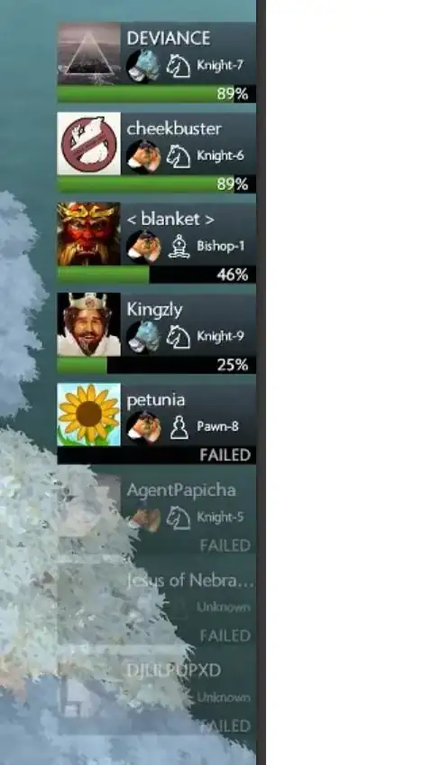

Sorry for my initial question being quite vague. Basically, I'm trying to replicate this with Photon. I've got various things set up but was stuck at where designating individual players to individual player info panels as if captured(Get WHAT to connect to those UI elements I've got set up).
It'd be simple enough even for me if this was a singleplayer, but since it's not I'm also refactoring a lot on the way as well. Thanks to both of the answers given so far I'm looking into Photon UtilityScripts(To a novice to anything simply directing where to look helps a ton, so thanks again), but since I'm not quite there yet I'll update my progress.
