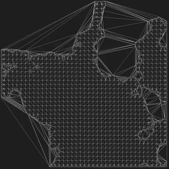

However, the problem now is how to make the triangles. I found a nice implementation of the Delaunay triangulation algorithm. However that yields me the following mesh: enter image description here
Obviously this algorithm is not aware of what's inside my cave and what is not and thus forms triangles completely outside of the caves. Pruning those outliers does not yield good results because then the contours of the caves are interrupted.

You can compute the centroid of the triangles that make your mesh and cull them if they are outside your original boundary.

You have the solution in your last line "that allows me to limit the maximal length of vertices" If you have the code which is generating the good mesh, except for the outside zones, you can add a line to check triangle's size as it is written by the meshing code.
You can alternatively write a brief function which fetches your triangle point arrays, and checks every triangle size in the model. You can either rewrite a new mesh with new vertex indices, or you can go cheap, and resize triangles that are too big, so that all three points are the same point.
Triangles can occupy an infinitely small point in space, and it makes them invisible to the graphics card. you can rewrite the big ones small else erase and re-index them, either in the triangle checking stage of your meshing code, or in a mesh editing function afterwards. for a mesh of that size, it would take about 1 frame of time.

    I cannot just remove the triangles that are partially outside of the desired area because some of their vertices form the outline of my cave! It would be great if I could remove just the wrong vertices, but how do I form a triangle from the remaining two vertices again?
    Have already thought to search for the nearest anchor point, but then I have triangles that overlap...
    – DragonGamer Oct 12 '19 at 18:15
  • Sorry, i meant: you can add a some lines to check triangle's size as it is written by the meshing code.Every triangle is written in a loop of the meshing code. I edited that ages ago for a snap-MC version of marching cubes: it's the blue pics here: https://stackoverflow.com/questions/35112181/marching-cubes-very-small-triangles you are doing the same thing, except for the large edges and not the small edges. – bandybabboon Oct 12 '19 at 18:55
