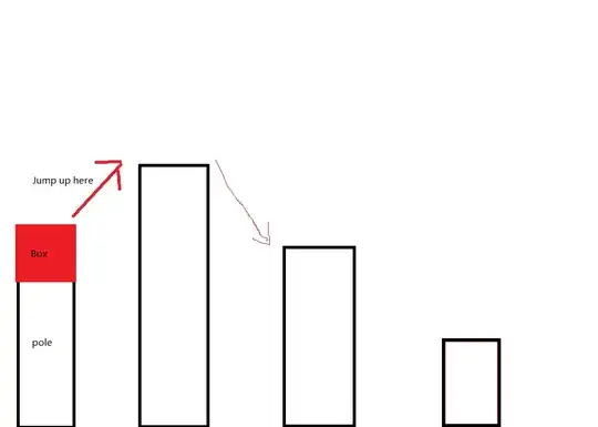

Desired Outcome:
For example,the velocity added to the box is to let the box jump from pole to another pole and stand on it.
The velocity is define by using the time user hold on the screen,the longer the user hold on screen,the greater the velocity,means the x,y value of Vector2 is define by the timeHolding.
Now when I hold the screen for the long time,the box will jump to the 3rd or 4th pole,and it not guarantee will reach the pole.Like everything is by chance.
What I want is,the box will jump from 1st pole to 2nd pole,from 2nd to the 3rd and continuously.At the same time,the velocity to go higher or lower and the distance is depends on the time user hold the screen.
This is what I want and my limited understanding of the problem.
