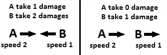

We have two GameObjects with colliders, A and B. They can move in any direction (top down game with 360° movement possibilities).
  • First case (left): A goes to the right at a speed of 2, B to the left at a speed of 1 and they collide. I'd like to calculate that A takes 1 damage (from the speed of B in its direction) and B takes 2.
  • Second case: A goes to the right at speed of 2 and B to the right at speed of 1. A takes 0 damage and B takes 1.
I am using Collision2D which doesn't have "impulse" property. I have no idea how to calculate thing like this manually.
