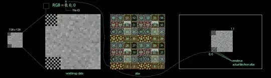

In order to do this, you pass two textures to the shader: the sprite sheet itself, and a texture containing tile IDs.
Sprite map (I know some tiles repeat but ignore that, this could be any spritesheet):

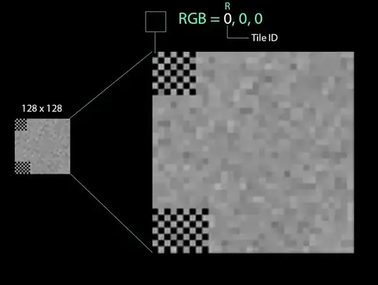

Below: Entire tile world represented by a 128 x 128 texture map, where each RGB value holds actual Tile ID for that location on the map. There are more efficient ways to represent the actual tile ID. Here, for the sake of simplicity, it is stored in the R component.
Putting it all together:
The right-most square is the screen output. On the image I just repeat texture... but what should actually happen is a tile world rendered from tiles on the sprite sheet.

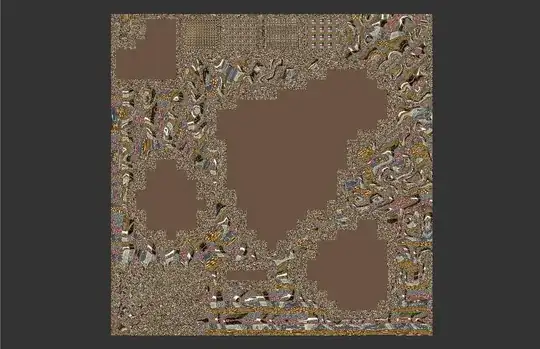

Update #1 -- I was able to get position sampling to work.
I painted a bit on the world map:
It's not perfect but definitely a step forward:
Adjustments made to the fragment shader:
float cols = 128.0f;
float rows = 128.0f;
float tex = texture2D(ourTilemapDataTexture, TexCoord).r;
float tey = texture2D(ourTilemapDataTexture, TexCoord).g;
vec2 UV = vec2( (TexCoord.x * (cols) / (tex * 32.0f)),
                (TexCoord.y * (rows) / (tey * 32.0f)) );
color = texture2D(ourTexture, UV);
Sure it's not 100% correct but at least map indexing works now :)

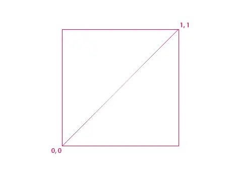

Instead, give your quad different texture coordinates.
For the sake of simplicity look at the following image:
Now, we know that our "atlas" texture has 2x2 tiles. So, we give our quad texture coordinates (0,0) to (0.5,0.5), which is, each coordinate axis is 1/number of tiles per direction.
Now when we want to draw a red tile, we send two uniforms (1,1) to the gpu program: The index of the vertical, and horizontal tile. This becomes our offset, and is computed in the vertex shader (normal vertex shader code omitted for brevity):
uniform vec2 offset;
void main() { out.uv = uv += uv * offset; (member by member multiplication and addition) }
Thus the uv minimum becomes (0.5,0.5) to (1, 1).
in the same way, to draw a yellow tile, your offset uniform would be (0,0), green would be (1,0), and black would be (0,1).
Because you are doing it in the vertex shader, the coordinates can be interpolated for each fragment using hardware, and the texture prefetch optimised for the fragment stage as normal.
