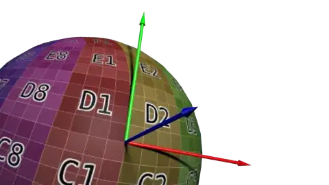

Tangent is a regular math term. As google describes it:
a straight line or plane that touches a curve or curved surface at a point, but if extended does not cross it at that point.
It's always perpendicular with the normal vector.
It can be calculated from the normal vector alone, but since there are infinitely many tangents to any 3d vector, it's not always ideal to let OpenGL do it. It's used to create a 3d coordinate system where the normal always points upward (with two perpendicular axes, there can only be one, that's perpendicular to both). Illustration from http://www.opengl-tutorial.org/hu/intermediate-tutorials/tutorial-13-normal-mapping/:
Vector based coordinate systems are great, because we can create matrices, that transform arbitary vectors from the global coordinate system into the one we defined (in this case, into the tangent space) and vice-versa.
OpenGL probably uses the tangents to do normal mapping, since normals maps (almost) always contain the vectors in a local coordinate system. You need to transform them from the tangent space back to global space for them to be useful.
