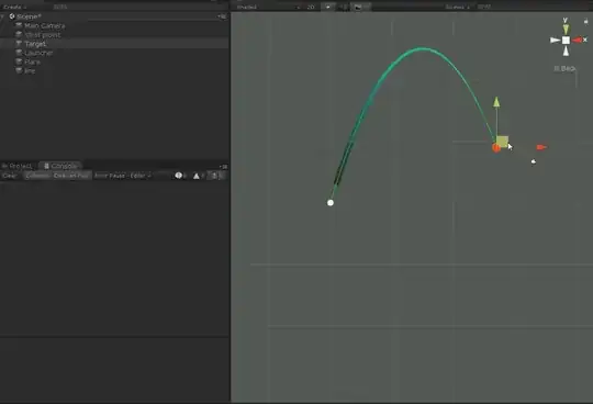

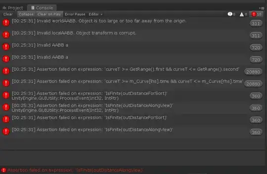

but there is problem with this script .if i move the target object somewhere above the starting point the curved path will be diapered and i get couple of errors.in fact when ever the path is about to become a straight line the errors will pop up . here is the screenshot of errors
enter image description here and here is a gif file to show when the problem shows up

That happens, because the force/speed wasn't enough to reach the specified point. You need to somehow detect this case and do something.
There are a couple of Debug.Assert calls somewhere in your code (you didn't post that part). Those cause the errors. Remove them and replace it, so that the player gets alerted of them (like an in-game message saying "the ball can't reach that spot")
