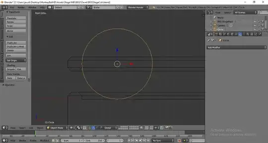

The problem with this method is, when I hit a wall, the player will begin to bounce erratically. The collision I'm using to test this looks like this (player to scale): Diagram of level collision from side, player to scale

  • Please add a video to showcase the first method – Coldsteel48 May 17 '19 at 02:04
    @ColdSteel Added! Let me know if that is not sufficient. – Yoshimaster May 17 '19 at 02:15
  • Seems like the problem is that it bouncing way too much than it should ? Probably it calculates the bounce for each triangle - so the bounce back force adds up like that, now I see why you came up with the second method you want to bounce back of only one surface (that is the closest) right ? – Coldsteel48 May 17 '19 at 02:16
  • I set the rebound factor to multiply the velocity by 0.7, so I'm not sure why this would occur. Even it it detected multiple collisions, that would only decrease the velocity even further. However, even a gentle touch is enough to cause a huge bounce. – Yoshimaster May 17 '19 at 02:18
  • what are you doing with accumulated normal ? What happened if you break the for each loop after the first collision occurred ? Does it still bounces like that ? – Coldsteel48 May 17 '19 at 02:23
  • Using it to calculate the angle between the velocity and the normal, so I can calculate friction properly. I'm confident that the code that does that works fine. – Yoshimaster May 17 '19 at 02:24
  • Am I doing things in the right order? Am I resolving the collisions correctly? I'm not sure how to handle multiple triangles. – Yoshimaster May 17 '19 at 02:25
  • ‘DepenetrationVector = ( Velocity - subVelocityToReacTheClosestCollisionPoint) Which is... (Velocity - (collisionPoint - SpherePoint))‘ – Coldsteel48 May 17 '19 at 03:01
  • Is the ball allowed to jump over the wall? If not, you can add an invisible infinite wall that would make the calculation of collision easier, without the need of looping over triangles. – Turms May 17 '19 at 04:38
  • @Turms It is allowed to, yes. – Yoshimaster May 24 '19 at 21:27
