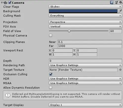

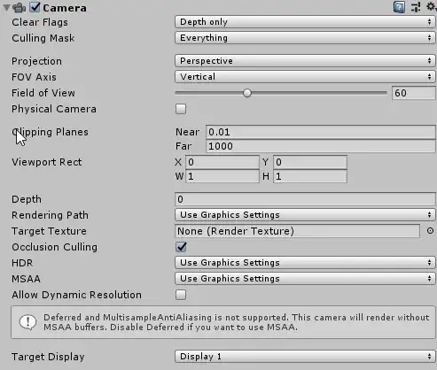

The first person asset uses two Camera objects, a Camera and a First Person Camera. Both had the Near Clipping Plane set to 0.01. Changing that value on the root Camera object solved the flicker, and did not interfere with the First Person Camera's view of the character arms.
The "Camera" object:
The "First Person Camera" child object:
