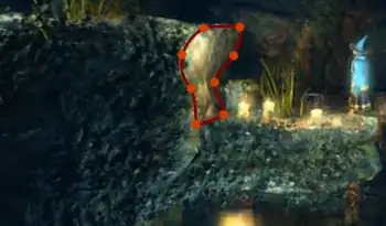

How did they make the terrain in trine? I think they took a polygon approach. It doesn't seem that they used a heightmap because it is in all three vectors, or a voxel method because it doesn't have overhangs and cliffs. If it is polygon-based (I assume it is), how in the world would you texture the whole thing?
Terrain
Notice how it's not very symmetrical and has lots of depth:
Terrain2

    They built a polygon landscape and used a bunch of textures and props, just like in any other game. What's so special about Trine's approach that has you intrigued? – doppelgreener Sep 11 '11 at 02:45
It looks like any regular 3D model. The only thing that's "2.5D" about it is the fixed camera and play space.

They use the same models again and again in Trine. They use a lot of batched rendering. Because of their unique camera angle, a lot of the meshes get culled with frustum culling.
The levels are hand-made by artist. They are just very good at re-using the same models over and over again.

The terrain is built as separate meshes by the artist, and possibly have a separate level designer to place the meshes for making the levels. They are just so well-modeled to give the impression that it's one continuous terrain.
In some respects it's really a 2D puzzle action game, making the design and programming of the game logic easier than fully 3D games. The level designer is restricted to just placing the objects along a 2D plane.
