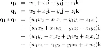

The quaternion multiplication shows a little complexity: while the a quaternion can be written as q = w + x i +y j +z k thus p · q is a simple polinomial multiplication, there are the relations so:
complex relations
we can say that a multiplication between quaternion can be written as:
general quaternion multiplication
this lead us to the conclusion that if q1 is the vector Q = [W1, X1, Y1, Z1] then
matrix form
so q1 · q2 = Q · A in term of matrix multiplications.
