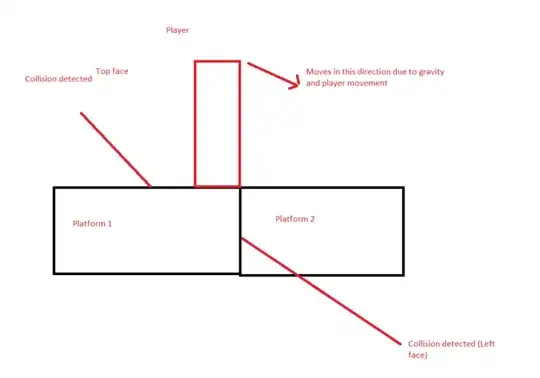

i'm facing an issue at the moment in my javascript/html platformer game that despite searching for this issue i can't solve. The problem is this:
When i place two platforms next to each other and the player moves between them, the algorithm believes the player is colliding with the side (left or right) face of the next platform. This is because all my bounding boxes are placed in an array and iterated through, the algorithm doesn't care if the player has to pass through one collider to get to another, it just thinks it has collided with both.
One solution is of course to make it consider what it has collided with first, another is simply not to place two platforms together. My solution would be to implement a kind of occlusion culling with collides, which if the player collides with a top face it can't collide with a side face if that side face's top face is higher or equal to top first that was being collided in.
That was hard enough to explain let alone implement and i just feel like there is a better work around that wouldn't be too difficult to implement and would be efficient.

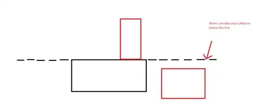

My solution:
Another solution is to disable gravity if the player is in contact with the ground, this must be done carefully not to trigger an oscillation effect and also means that two iterations need to be made, one for collision in the y (done first) and the other for collisions in the x (done second).
