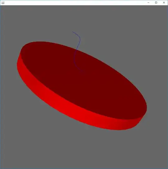

The image below shows the relative shape of the objects and how they can come into contact (the red disk is the moving object). In this screenshot its contacting an end point of the curve, but it will commonly contact anywhere between the end points of the helix.
Contact

  • No in this scenario it is an actual helix (basically a spring) that is stationary and the cylinder is the object in motion. Also the spring is big enough that the cylinder can fit between the 'loop's so to speak so i can't just take the endpoints of the spring and make an estimation. – John Hill Apr 01 '19 at 23:01
