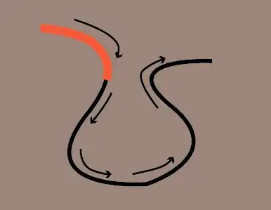

Based on the image below, I have a curve (orange) which is a bezier sub-curve of an original curve (longer black curve). The original curve consists of a number of cubic bezier curves joined together. How can I move the sub-curve (which could be contain more than one cubic bezier curve) along it’s original curve whiles preserving its length?
Please note that the original curve/spline could be open or closed curve with the ends joining. I know that arc length is key to achieving this, but I’m not sure to do this.
