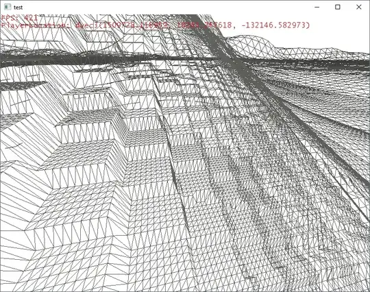

However, I want to scale this up to the size of the actual moon. Unfortunately, when I do so, stepping artifacts appear:
Stepping artifacts on the side of a large crater
Now I am (almost) certain that this is simply an issue with floating point precision; 32-bit floats just simply don't have enough precision for planets of this size. However, I am in an interesting situation where I cannot simply change one of my numbers to a double to gain more precision. My vertex shader code is this:

OpenGL's texture() function only seems to take float parameters as an input. This makes me believe that this stepping is a result of the cast down to a lower-precision vector, where the program cannot distinguish the tiny change in angle between each grid position. At first I thought it might have been a texture precision error, so I tried switching the heightmap texture to an 8-bit copy but I didn't see any difference in step size or quantity. The texture filtering is linear, so the heights should be smoothly blended between one another, and at large scales big landforms like mountains and hills seem to have no associated problems.
Can anyone confirm that this cast in the texture() call is the reason for the stepping? If so, is there a way to pass high-precision numbers into a GLSL texture call, or, failing that, a solution to this problem that doesn't involve a complete redesign? I was thinking about maybe getting a weighted average of each neighboring "step", and then linearly interpolating between them, averaging between the areas where the float breaks down. Would something like that be possible, or is there a better alternative?

    Hey @DMGregory, It turns out that your question "Low Quality Bilinear Sampling" was incredibly useful and the solution to my problem - the problem was the poor hardware interpolation rather than numerical precision. I just switched my own custom linear interpolation algorithm using doubles and the problem has gone away completely at real scale. I don't think I have enough reputation yet to answer my own question, so if you want to submit your own answer I will mark it as correct. – RedRuin Feb 20 '19 at 23:09
You should divide the heightmap into manageable chunks, use precise integer math on the CPU to decide which one to use, load it in the shader and use local coordinates when querying the texture.
