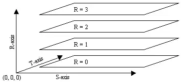

Lets look how this is used in 3D textures. 3D textures can be created by layers of 2D textures, and interpolating the texels in-between. Visually a 3D texture could look something like this:

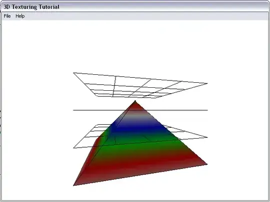

Where the "planes" in the R axis are 2D textures. If we were to set each layer to a different solid color, and apply this to a 3D object, we'd get something like this:

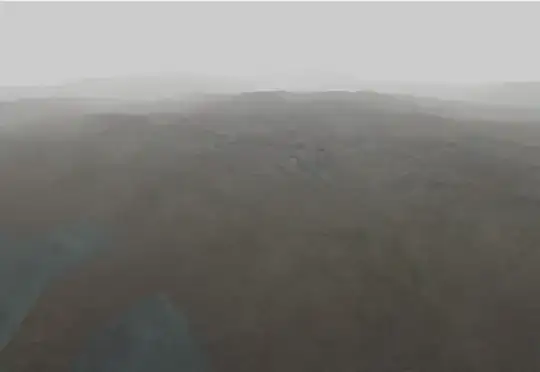

You can see how the solid colors have been interpolated in-between the layers. Here's the same type of thing, but with a landscape. Where from top to bottom, the textures could be: snow, rock, grass, sand.
