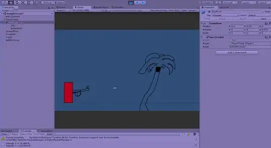

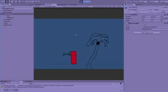

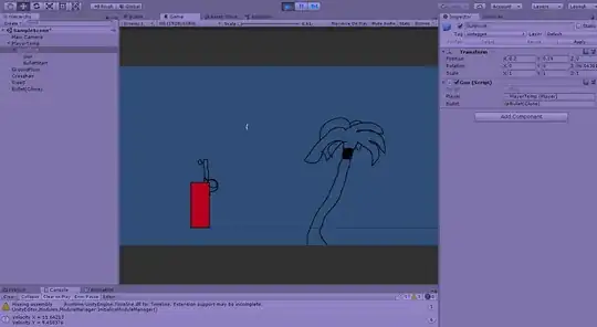

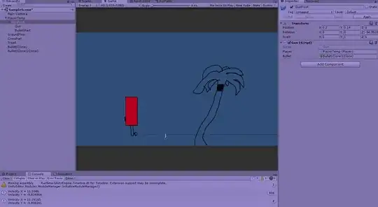

Its giving me funny velocities for the angle i shoot from when the placeholder Gameobject class is rotated, shown below:
Do i need to do more to the velocity? like conversions to radians or something? Or is doing the Pythagoras thing all wrong. I've been scouring the internet all day.Thanks for any help.
The 'Bullets' travel from the muzzle to their location on the images
Shot 1
Shot 2
Shot 3
Shot 4
