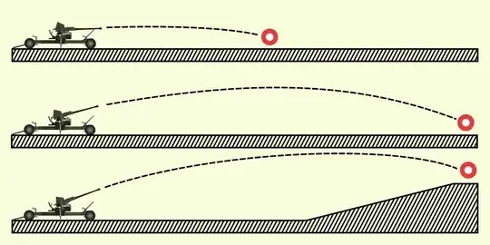

I am trying to determine the gun elevation angle of a gun that fires ballistic projectiles.
For a target at a certain distance D, I will have to compute an angle that increases with D.
This relation ship is non-linear, by the way, because the projectile loses velocity as it travels, for starters, due to drag.
In the past, I have done this with a lookup table.... for a whole bunch of test firings, see where the projectile hits the ground.
But this only works if there is no delta in the elevation between gun and target.
A target that is on a hill top, will need adjustment for extra range. Whereas a target in a valley below, would mean a lower gun elevation.
This means that the table-lookup will break down, and a 2D table seems like a kludge.
What would be an effective way to compute this targeting? I know things also depend on nozzle-velocity and air-drag, but these will not vary (but drag will be non-zero.) Neither will I be modeling the wind.

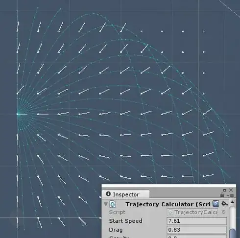

Per @DMGregory who posted a link to Oskar Stålberg's tweet.
By far the easiest solution is a 2D lookup table. Personally, I fill the table by sampling of test firings. I perform test firings by stepping through the range in steps of 0.02 radians, which is 1.146 degrees. For my purposes, this has been accurate enough.
It will be able to handle complex stuff like air drag that scales with the square of the velocity.
The only downside: if you tweak your simulation, you need to re compute the tables.
