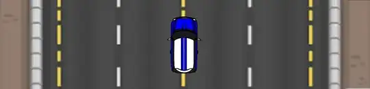

car during movement forward ,back & idle
car during movement right & left
this is car controller

Sh.Adel
  • 191
I solved this problem (Rotation Distorts Object) with putting car sprite as a child of empty gameobject.
