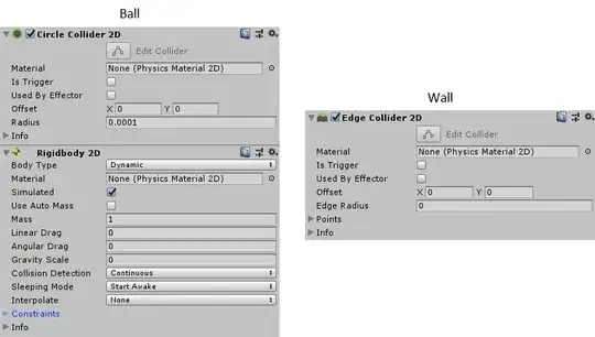

In my top down perspective game, I have a ball that bounces off of walls. The ball should behave in a way where it will always bounce off in a 90 degree angle. The ball can only move up, down, left and right and the walls are slanted so that they should always (theoretically) bounce a ball up, down, left or right.
On the ball object, I have a small circle collider 2D and a Rigidbody 2D attached, the walls have a single edge collider 2D attached. Approximately one time out of twelve times, the ball will simply pass through the edge collider, so it's not consistent.
How can I make sure that the ball always registers the collision?
Here's my setup:
The script I use to move the ball:

Additional info:
- every wall is it's own object with it's own edge collider.
- the ball always hits the center of the wall because I center the ball object using the center of the wall it touches. Note: I had issues with the ball passing through walls even before I implemented the centering.
This is happening because collisions happen in fixed update and you are moving the ball by its transform in the update. You should instead use Rigidbody.MovePosition, or apply a force to it instead or make it kinematic and move the transform but in Fixed update. Take a look at the rigidbody manual and this.
