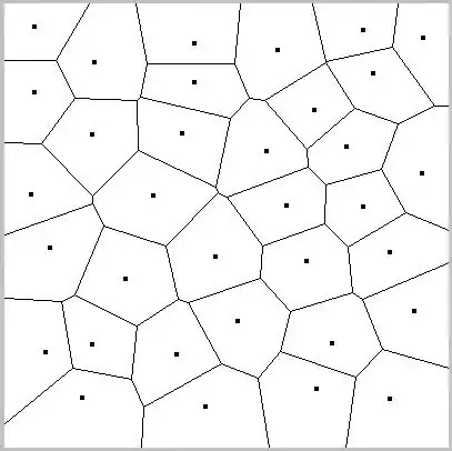

This looks like a texture you could generate from a voronoi graph, e.g.:
You can make small, smooth adjustments to the graph by moving the points; re-drawing the graph each frame would be quite expensive, so you'd likely want to pre-render the animation.
