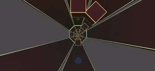

However, as I have set the tick to 1hz, there are unexpected results where the position seems to pulse, rather than smoothly transition. An example can be seen below.

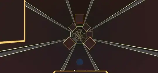

It can perhaps be seen more clearly without lerping
