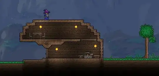

I'm looking to create a system that recognizes certain types of buildings and rooms you can create in game, like how Terraria detects "residences." In that game, a house can be constructed in a tile-based world by constructing a zone of blocks satisfying a set of conditions:
  1. The zone is completely insulated from the "outside" by player-placed blocks.
  2. The zone can fit a 5x7 rectangle.
  3. there is at least one table, one light source, and chair in the enclosed area.
  4. There is a door leading out from the zone.
  5. Terraria has both a foreground and background tile layer. The entire background of the zone must be filled with player-placed blocks.
How can I efficiently detect when a player has constructed a suitably-sized area, and how can I efficiently check that the area contains all the required furnitture/components?
Example of an interior zone that satisfies all the housing requirements:
