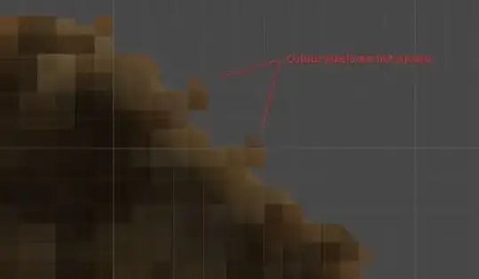

The problem (as portrayed by the image below) is that the pixels seem to be, for lack of a better word, cut off. I wish to either display a pixel, or not.
Result

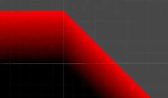

My fragment function, it uses the red value of the vertex colors (displayed by the image blow) on the edge of the mesh which are assigned during mesh generation to determine the pixel cutout "weight" by multiplying it with the texture.

The reason this happens is that your fragment shader doesn't run just once for each texel in your input texture. It runs once for each fragment in your output buffer (eg. each pixel on the screen).
So when you're drawing big, pixelated art zoomed in, you get multiple shader evaluations for each texel in the source. Each of those evaluations gets its own smoothly interpolated input from the vertex shader, like the vertex colours, to give you smooth gradients. That means the fragments at one side of a texel can get different inputs, and come to a different conclusions about whether to draw or clip, than fragments at the other side of the same texel, leading to the cutoff splitting the texel midway along.
To fix this with textures, we use Nearest / Point filtering mode to snap our texture samples to the center of the nearest texel. For interpolated data, we'll need to emulate that snapping behaviour.

First, we need to measure which way the colour gradient is sloping:
float2 gradient = float2(ddx(i.color.r), ddy(i.color.r));
The ddx and ddy functions compute screenspace partial derivatives, measuring how much the quantity inside increases as we move a pixel to the right or a pixel up on the screen. This gives us a gradient vector we can use to estimate the function's value at nearby pixels (assuming it's approximately linear, which holds for this case)
