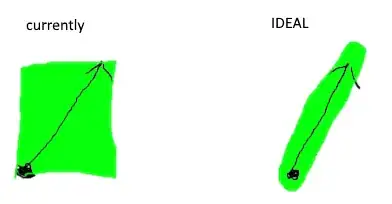

This post is a bit old, but it got bumped, so I'll followup with the solution I implemented.
I used the players velocity (multiplied by the framerate) to compute a simple 3D cartesian range of voxels that the player could collide with.
When moving diagonally, it tests more voxels than is required (as crudely sketched below):
However, at typical FPS & velocity, only about a dozen voxels are tested per frame (regardless of the size of the world). So I'm quite happy with it.
Seems so obvious now; can't believe I asked, lol.
