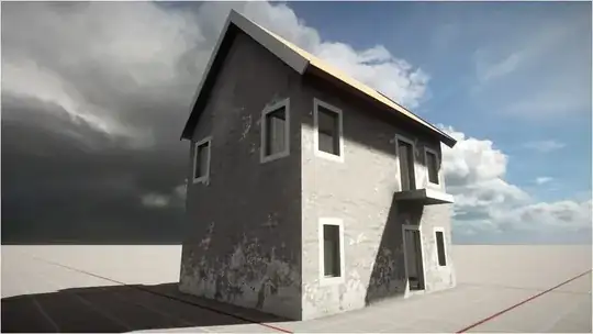

To put it simply yes that what they do. But the go an extra length to cover up the straight edges using destruction mask. After removing the part of the geometry, they add detailed mesh around the destroyed section to make it look believable.
Here is how it works,
When destroying a part of this house, we begin by removing a piece of the geometry
When destroying a part of this house, they begin by removing a piece of the geometry

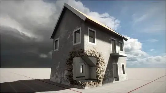

enter image description here Then added detail meshes around the destroyed section.

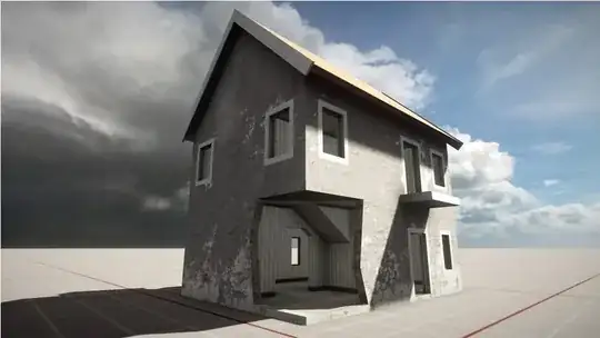

And the final step is to add the destruction mask.
They also use particle effects and mesh debris for more dramatic look.
