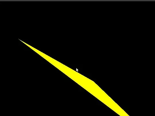

I have been having trouble with my camera, first encountering the roll tilt that is so many times asked... I fixed that issue by following the instructions at this link: Unwanted roll when rotating camera with pitch and yaw But now I find another issue, whenever I get close to my triangle, pitch becomes roll, and instead of moving up and down the triangle, the camera rotates around the plane of that triangle, see:
Pitch is fine, but as i get close the the triangle, it becomes roll
This is my code, I follow the same logic as the link above!

Edit: Also, switching the quaternion multiplication order or just using a normal pitch yaw roll method fixes the problem, but then the roll problem comes back!
Whiteclaws
  • 181
I fixed it by omiting the multiplyVec3(left... line and just using left as (1, 0, 0); Edit: I just clumsily moved the code, made a mistake and it solved the issue, but I believe I'm locking the rotation around the x and y axis hence left and up instead of rotating my object relative to the quaternion's own up and left vectors... I'm not sure why it fixes the problem but it does!
