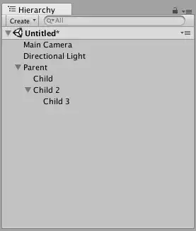

A "child object" is when you nest one object under another in the Unity hierarchy, as shown in this image from the Unity docs:
Unity Hierarchy Window showing parent & child objects
In code it looks like this:
 myGameObject.transform.parent = parentGameObject.transform;
A prefab could be a child object, if you instantiate it under a parent/container of some kind, eg.
myInstance = Instantiate(myPrefab, parentTransform);
A prefab can also contain its own child objects - you can have a whole hierarchy of parts making up one compound object.
