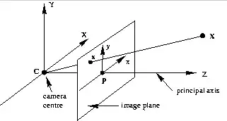

I need to define the principal of the camera. I prefer to refer to it as the principal line of sight. You can find it with other names such as "princial axis", "principal ray", etc.
It is the line that goes from the position of the camera, to the point that is projected at the center of the image. It is forward vector of the camera if you are working on a game engine.

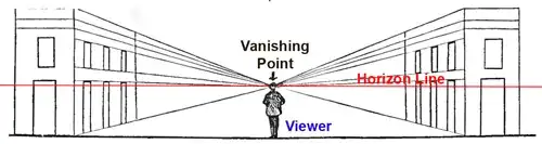

You are probably familiar with this effect. It is often worded as saying that the horizon on the picture is at the height of the eyes of the viewer:
The vanishing point and horizon line are at the height of the eyes of the viewer.

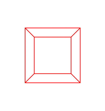

Now, we say we have a one-point perspective when the scene has mainly lines that are parallel or perpendicular to the principal of the camera. In this case you will have a single vanishing point at the center of the image.
One point perspective
A cube depicted in one point perspective.
Notice in the image that the depicted cube only have lines parallel or perpendicular to the principal of the camera. As a result it has a single vanishing point at the center of the image.

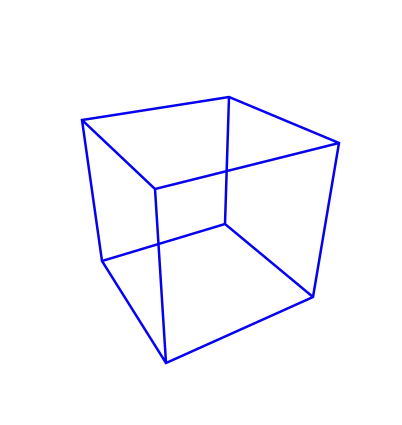

If we now rotate the camera to an angle where there are no longer lines perpendicular to the principal of the camera we end up in three point perspective.
Three point perspective
A cube depicted in three point perspective.

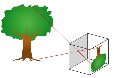

Our objective is to capture the behaviour of a pinhole camera. We are disregarding depth of field, optical and chromatic aberrations. That is, we only care about the geometry.
Pinhole camera
Our pinhole camera has:
  • Focal length
  • Position
  • Orientation
Notes:
  • The Focal length of the pinhole camera is the depth of the camera (from Latin camera "a vault, vaulted room").
  • The pinhole camera also have an apperture size. The apperture affects depth of field (what is the distribution of things in focus) and exposure, it and may introduce some aberrations such as Vignetting. We do not care of any of that.
The first step is to transofrm the world space into camera space. That is, we need to do a coordinate system transformation such that the camera ends up at the origin, looking down the z axis and with the x and y axis corresponding to the camera Roll.
Once you have your system in camera space, doing an orthogonal projection is trivial: take the x and y coordinates, scale and offset to match the viewport.
However, instead we want perspective. Thus, what we are going to do is scale things depending on the distance to the camara (their position on the z axis).

Notice that the pinhole model yields a flipped image. While we can just invert the coordinates after we are done. It is simpler to think of it as placing the projection plane in front of the camera instead of behind. The model now looks like this:
