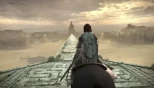

How can I perform seamless rendering of long-distance vistas in a fashion suitable for an open-world game (e.g., where the player is relatively unconstrained in how they traverse the world)?
For the purposes of this question, I'm only concerned with rendering of static objects: terrain and large props, as my game world is relative devoid of dynamic actors outside of the player.
The PS4 remake of Shadow of The Colossus™ illustrates the kind of effect I'm going for:
SS from http://www.businessinsider.com/shadow-of-the-colossus-remake-playstation-4-video-2017-9
