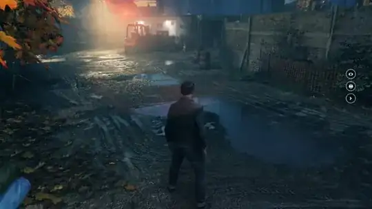

In my game I need to create dynamic water puddles but I cannot find a tutorial that shows how I can make such an effect (an example of which is shown below). How can I do it?
Quantum break

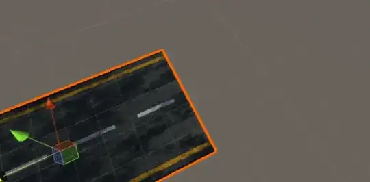

Reflection
To create a wet shader, you first need to have a reflection.
SimpleRoad
You can use a Reflection Probe or a MirrorReflection3 but, I use a fake reflection (Cube Map) here because the shader can then be used on mobile.
Reflection

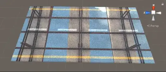

Distortion
To add distortion to your reflection, you can multiply the normal map and the worldRefl:
float3 distortion = tex2D(_Distortion, IN.uv_Distortion);
o.Emission = texCUBE(_Cube, IN.worldRefl*distortion).rgb
distortion

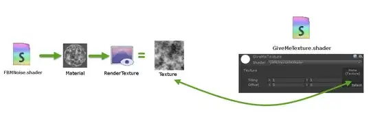

The FBM above shouldn't be used directly in to your shader because it has many GPU calculations and decreases performance. Instead of using directly, you can render the result to a texture with RenderTexture.
Shadertoy uses multiple passes, one per "buffer". As the name indicates, this pass stores the results in a buffer, which is just a texture. Unity will let you render to textures too.

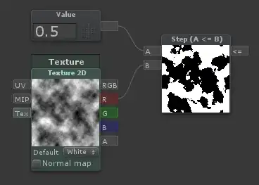

Creating Mask

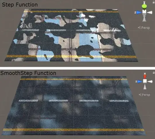

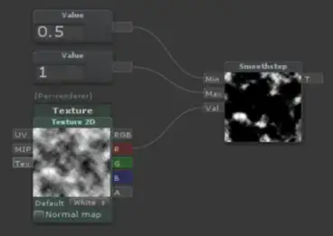

You can make a thick and smooth mask with these functions:
Step
step
Outputs 1 if [A] is less than or equal to [B], otherwise outputs 0.
Smoothstep
smoothstep
Blends smoothly between two values, based on where a third value is in that range, outputting values between 0 and 1. Think of it as a clamped inverse lerp with a smoothed output value.
Result

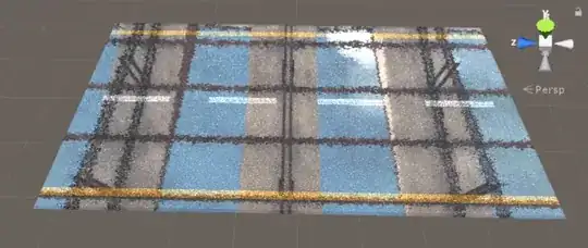

/* Warning: don't use this shader because this is for preview only.
It has many GPU calculations so if you want use this in your game you should
remove the FBM noise functions or render it to texture, or you can use an FBM texture
//Created By Seyed Morteza Kamaly
Shader "Smkgames/WetShader" {
Properties{
_MainTex("MainTex",2D) = "white"{}
_Distortion("Distortion",2D) = "bump"{}
_Cube("Cubemap", CUBE) = "" {}
_BumpMap("Bumpmap", 2D) = "bump" {}
_Metallic("Metallic",Range(0,1)) = 0
_Smoothness("Smoothness",Range(0,1)) = 1
_ReflectAlpha("ReflectAlpha",Range(0,1)) = 1
scaleX("UV.X scale",Float) = 10.0
scaleY("UV.Y scale",Float) = 10.0
_Smooth("Smooth",Float) = 0.4
_Intensity("Intensity",Float) = 1
SubShader{
Tags{ "RenderType" = "Transparent" "Queue" = "Transparent" }
LOD 200
Pass{
ColorMask 0
ZWrite Off
Blend SrcAlpha OneMinusSrcAlpha
ColorMask RGB
CGPROGRAM
#pragma surface surf Standard fullforwardshadows alpha:fade
struct Input {
float2 uv_MainTex;
float2 uv_Distortion;
float3 worldRefl;
float2 uv_BumpMap;
INTERNAL_DATA
sampler2D _MainTex, _Distortion;
samplerCUBE _Cube;
float _Metallic,_Smoothness;
float4 _EmissionColor;
sampler2D _NormalMap;
uniform fixed scaleX, scaleY, _Smooth, _Intensity,_Alpha,_ReflectAlpha;
static const float2x2 m = float2x2(-0.5, 0.8, 1.7, 0.2);
float hash(float2 n)
return frac(sin(dot(n, float2(95.43583, 93.323197))) * 65536.32);
float noise(float2 p)
float2 i = floor(p);
float2 u = frac(p);
u = u*u*(3.0 - 2.0*u);
float2 d = float2 (1.0, 0.0);
float r = lerp(lerp(hash(i), hash(i + d.xy), u.x), lerp(hash(i + d.yx), hash(i + d.xx), u.x), u.y);
return r*r;
float fbm(float2 p)
float f = 0.0;
f += 0.500000*(0.5 + 0.5*noise(p));
return f;
float fbm2(float2 p)
float f = 0.0;
f += 0.500000*(0.6 + 0.45*noise(p)); p = p*2.02; p = mul(p, m);
f += 0.250000*(0.6 + 0.36*noise(p));
return f;
void surf(Input IN, inout SurfaceOutputStandard o) {
fixed4 c = tex2D(_MainTex, IN.uv_MainTex);
o.Metallic = _Metallic;
o.Smoothness = _Smoothness;
o.Alpha = 1;
float t = fbm2(float2(IN.uv_MainTex.x*scaleX, IN.uv_MainTex.y*scaleY));
float fbmMask = step(t, _Smooth)*_Intensity;
o.Emission = texCUBE(_Cube, IN.worldRefl*distortion).rgb*_ReflectAlpha*fbmMask;
o.Albedo = float4(1.0, 1.0, 1.0, 1.0)*tex2Dlod(_MainTex, float4(IN.uv_MainTex, 0.0, 0.0));
ENDCG
Fallback "Diffuse"
