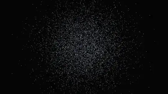

I'm trying to draw sphere galaxy mentioned in this tutorial: http://martindevans.me/game-development/2016/01/14/Procedural-Generation-For-Dummies-Galaxies/
Here is an image for reference:
Basically, it is just a (3D normally-distributed) set of small (few pixels) spheres.
I believe if I draw it using some primitives (like circle) it would be very slow (drawing thousand of circles every frame would be too expensive even in pure opengl). So I've decided to write a small shader for that purpose. It should be pretty simple, but I don't even know where to start.

    The tutorial you link to doesn't use a special shader for this. It does exactly what you propose "would be very slow": plotting each star as its own independent primitive, and it seems to run fine on my several-years-old phone. So you might be optimizing prematurely here. If you want to proceed with a shader-based approach, can you outline at least a little about the strategy you want to use? (eg. will this be rendered as an image effect on a quad, or on particular shaped geometry? Does it need to support motion/a moving perspective? Etc. – DMGregory Jan 14 '18 at 18:40
  • @DMGregory, sorry for a delay: the library I'm using (SFML) only provides a 2D primitives. I can probably achieve that using particles system, but then particles will be just pixels (points) where I want it to be a small primites (e.g. spheres, having several pixels radius). I also can imagine doing that in pure opengl, but I'm not sure how to apply post-processing then for each primitive in a group. – despero Jan 15 '18 at 19:18
  • Regarding to shaders:I want jsut generate (with normal distribution) a set of small bright circles ("stars") so they create an irregular sphere. Later, I'll render this as a rectangle on top of my window. Take a look at this example: https://www.shadertoy.com/view/llSGR1 It is very similar to what I want to achieve. – despero Jan 15 '18 at 19:21
