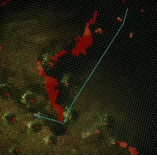

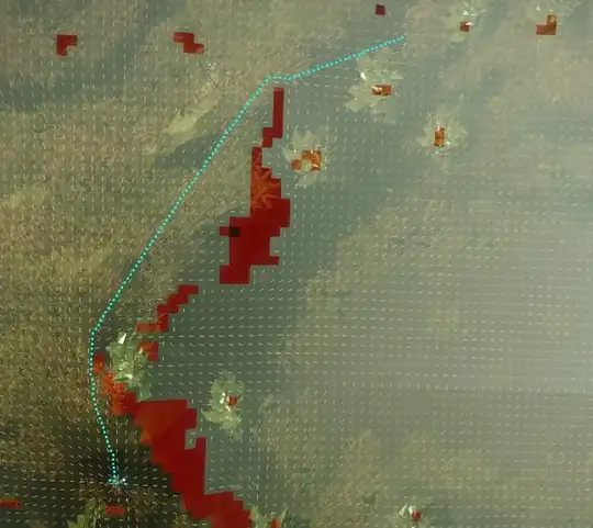

Here's an example grabbed from my game showing an overlay of the gradient of the potential field and a path that follows it.
Potential Field and path
If you have a nice smooth field, one idea I wanted to investigate was that of using the curl of the potential field to send agents on a flanking route for a short while, before returning them back to using the gradient to go directly towards the goal.
Curl of potential field
