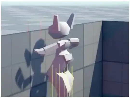

For ledges, I would trace both horizontal and vertical rays.
Something like shown in this movie by Tim Dawson: still from ledge test movie

    I already do this, but with shapes different than cubes, it results in non-desired results. rotate a cube 45 degrees in pitch and it won't find the ledge anymore) – Raildex Dec 10 '17 at 01:01
  • If you radially fan out the forward segments, you can approach the wall from an angle. If the wall itself is at 45% angle, it would be more of a hill than a wall w ledge, would it not? – Bram Dec 10 '17 at 01:26
