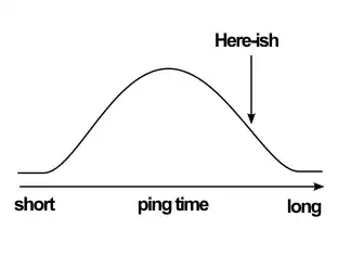

  1. Calculate the average-worse (right-ish side N-percentile of the bell curve) ping time in ticks with a small margin (eg: 10 tick ping +2 ticks variation) enter image description here
  2. Client send input/command to the server scheduled for (now_tick + ping_ticks) (eg: now 50 + ping 5 = tick 55)
  3. Server receives the command (ping_ticks / 2) later, relays it to the clients
  4. Clients (hopefully) receive commands before they're due (eg: received on tick 53) and execute command on the tick that was calculated as the post-date (eg: tick 55) so everyone is in sync.
